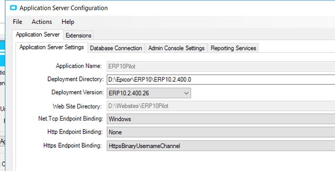

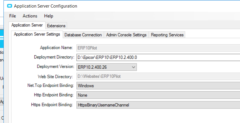

This is what I currently have:

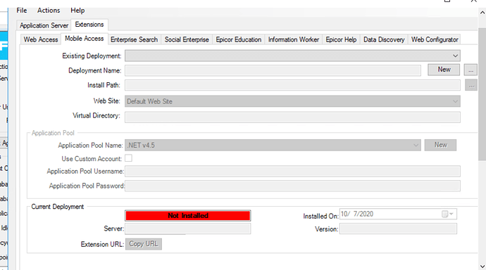

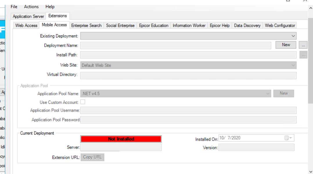

As for mobile access, I don’t have it installed (didn’t know that):
Do I need to configure that to access the app?
No you don’t need that.
You just need to setup REST, that means using https, a fqdn and ssl certificate matching that fqdn from a valid certificate authority.
Then on the app just enter the url https:// < yourserver FQDN >/< your instance, e.g. epicor10 > and your epicor username/password.
