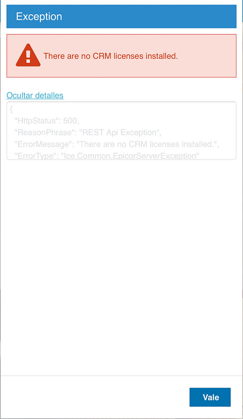

Well I think that if it was a problem with the validation of the certificate, I could solve it with the Letsencrypt certificate. Now the error I have is this: It tells me that I do not have CRM licenses.

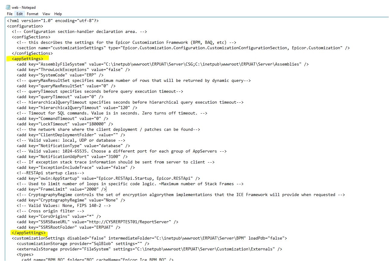

Even modifying the web.config file adding it:
< add key = “CRMLicenseFallbackToDefaultUserAllowed” / >
under
< AppSettings >
This is silly but do you have CRM? ?
What does your license say?

The “No CRM Licenses” is possibly due to an issue with 10.1.500.XX. I have a support ticket open on that one.
I had it confirmed from the mobile CRM development that the CRMLicenseFallbackToDefaultUserAllowed parameter does not work on version 10.1.
I had to purchase stand alone CRM licences to get it working on 10.1.6.
Yep, fortunately I applied an upgraded to 10.2.100 and the CRM Mobile app works, and still works on 10.2.400. I just have to renew the SSL certificate (LestEncrypt) every 2 months. :smiley:

We have Customer Relationship Management module licence and enable te CRM Mobile by adding this line on web.config file:
Hi
I am trying to install/set up Mobile CRM on 10.2.300.17
Is there any guidance on exactly where to add the lines to the web.config?
As soon as I place it in (where I think it should go) the application crashes.
e.g. exactly where does this go?
appears twice in our config and it doesn’t like me adding the line under either of them!
p5 of 10.2.300 install guide:
To enable the fallback to default ERP license, you need to open the web.config file and add the following line
under the section:
