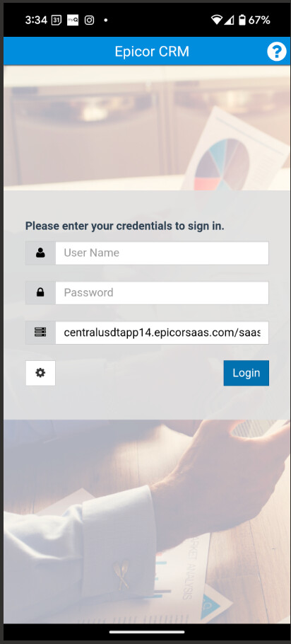

You should not use https:// and not use /home
This is the text I use for mine (with my SaaS number changed into XXX)
Live:
centralusdtapp14.epicorsaas.com/SaaSXXX
Pilot:
centralusdtpilot14.epicorsaas.com/SaaSXXXPilot

With SaaS, I am able to do this at the path I showed. This is what the server looks like on my app (with my SaaS number not showing):
