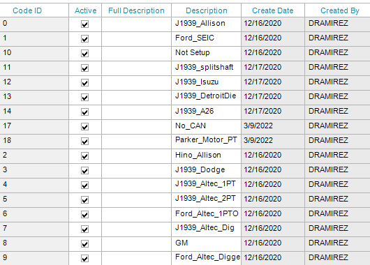

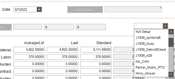

That all looks fine, are you doing anything to these combos in code?

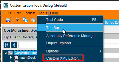

If you can’t try this trick
Open the screen in Customization Mode
Go to Tools-> Custom XML Editor

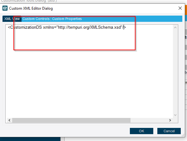

Under XML View Paste this XML

Click Okay, Save the Customization, Exit out and Open it back up. See if that works like I show on the Gif
Unfortunately, it does not work like the GIF. Same problem as my original form.
No_CAN and Parker_Motor_PTO both have a create date of 3/9/2022.
Here’s a trace that does show the where clause … but it doesn’t seem to work.

I mean 3/9 is less than 3/10 :yum: its passing in the 3/10 date in the filter. That is odd, try changing the date in the date filter and hitting the dropdown again, does that change anything?
well the second packet was from after I changed the date to 3/7/2022… and those values remain in the list.
I notice an inconsistency on this. In your where clause, it says CreatedDate, instead of CreateDate. Is that why it didn’t return any results?
The first screenshot I had mispelled it, but then I fixed it and it worked fine
