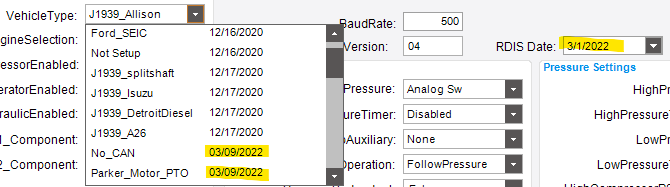

I agree. You answered my question. I did move on to a different one. I am using UserCodes to populate these drop downs but I want to limit the items in the list to only items whose CreateDate is earlier than another date on my dataview. I couldn’t do it with a filter (I think because the filters only work with strings).

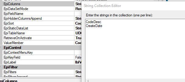

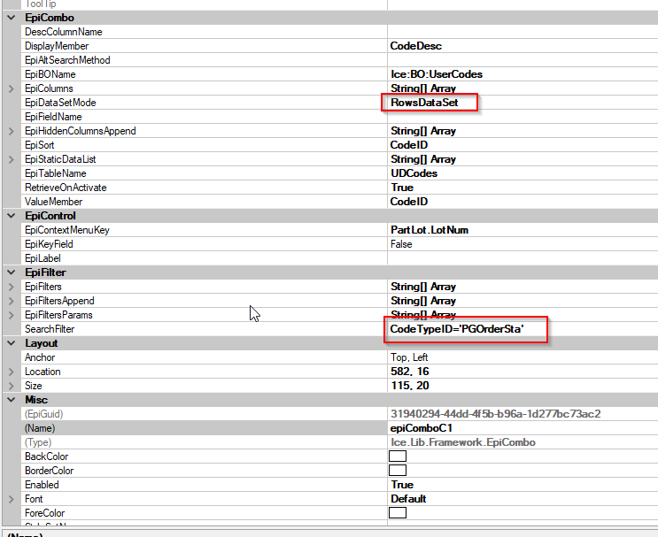

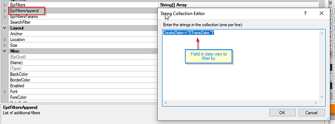

Try this setup
Works like a dream
FilterByDate
There are very very few I can count them with a single hand reasons why in an Epicor customization you should ever iterate over controls. The architecture of Epicor is such that each control is bound to a data view / data set and anything you need to do should be done to the data and not the control directly. Even the style of the control can be affected by the dataview properties.
Not saying it can’t be done this way, but it shouldn’t unless you have no other choice.

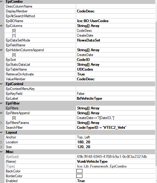

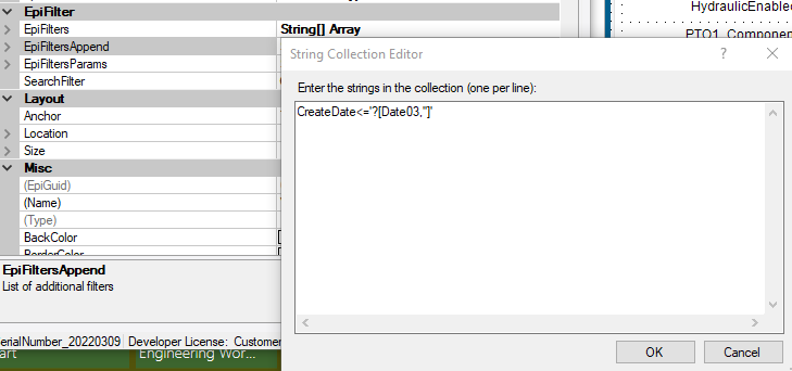

This is exactly the logic I thought should work… but I can’t get it to work. Just to be sure, after TransDate there is a comma and two apostrophes before the other bracket?
Maybe I’m losing my mind.
The RDIS Date is bound to UD38View.Date03.

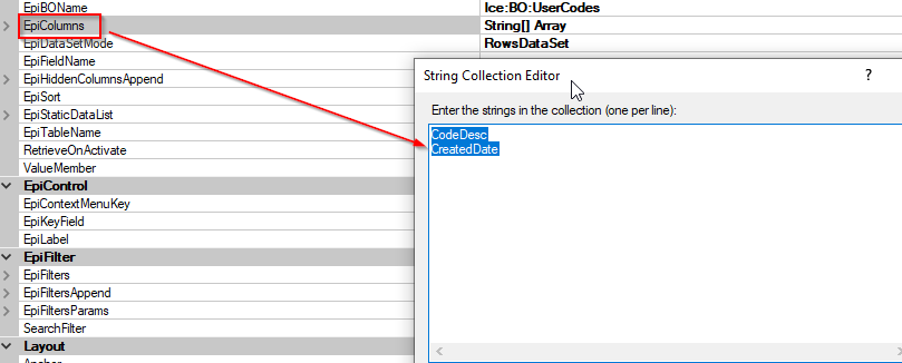

Here I am looking at the Columns.
Here I am looking at the FiltersAppend
Yeah
CreateDate<='?[TransDate,'']'

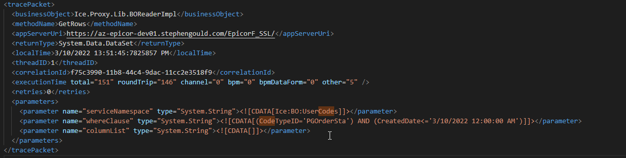

Do you get an error? Do a Trace / Changes only you should see the query in there.

I don’t get an error. When I did the trace, I did not find any reference to UserCodes like you have shown. I’m sure that must be part of my problem.

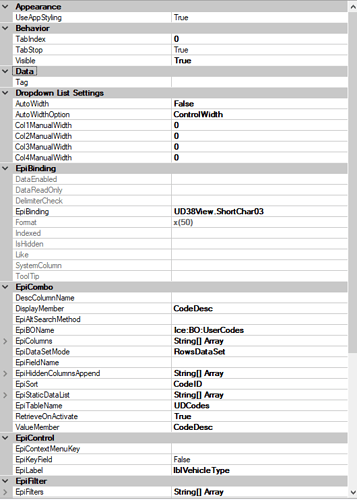

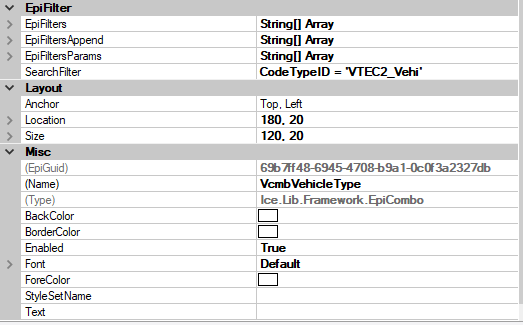

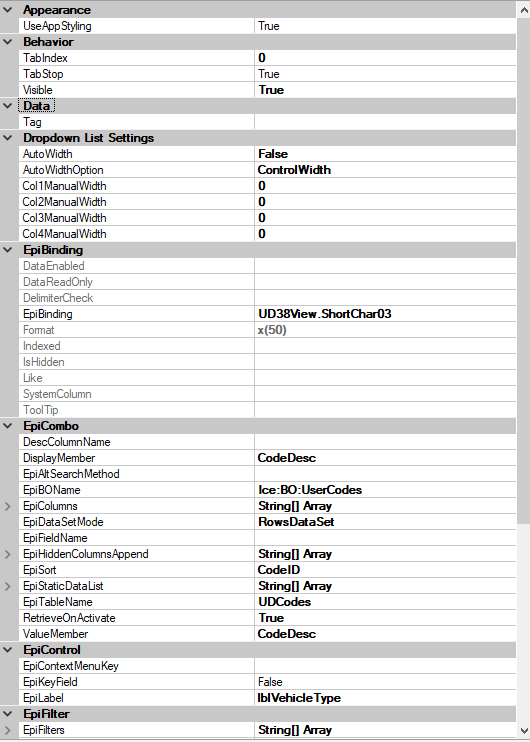

Can you send screenshot of your whole properties panel for the combo. Do you have retrieve on activate turned on?
Here, I expanded a few of the other fields so you can see what I have in them.
