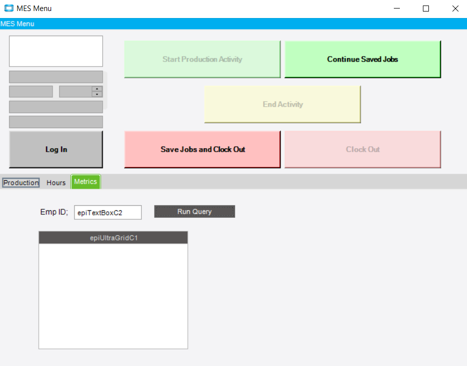

I have a custom sheet in MES that displays the results of a BAQ that looks at the hours a person worked. It subscribes to empbasic.empID. Right now it displays the correct result but the issue is that it does not clear the grid when you clock out or log out. The rest of MES clears but the grid shows the most previous results until another person clocks in.
I think the solution has to do with putting an oTrans.RefreshLaborData(); or oTrans.ClearDataSets(); somewhere in the code but I do not know where to put it. I would like it to clear the data upon pressing log out or clock out.

I could not make an event on the employee field because it is not a custom control so it does not show in the drop down menu.
I tried following all of the steps in the video to make a button that pulls a persons labor hours and everything seems to work. It compiled with no errors but if I close and reopen the customization it gives me a compilation error, removes the extra tabs I added and unhides all of the tabs I have hidden. I have tried this three times but every time I have to go back to the beginning.
I must be doing something very wrong.
