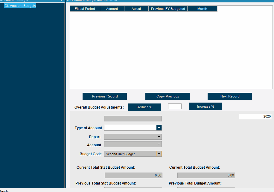

Hello I am trying to find a method that is executed when you select on one of these lines. I tried epimessagebox with no luck, only update is ran and I can’t execute my method on update because it ends up in a infinite loop. Could I please get some insight on how I am suppose to do this?

I hope this will help you understand what I mean.

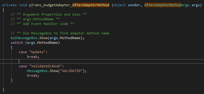

When I change the record on the left side ValidateGLBook() is called, so I was trying to find a way I can trigger my own method after ValidateGLBook() was called.
Did you try the wizard to create the AfterAdapter Method?
I did but this method isn’t called with this:
Using the epimessagebox with args.method name it never shows this method
