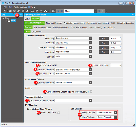

Do the US and Singapore plants show a Time Zone Offset value in the Site Configuration?
(#12 in the pict below)
And from the implementation guide:
Displays the Time Zone Offset value you need for this site. This value indicates how many time zones away from the server the current plant is located. This field is for display only. If you previously inputted a time tone offset value, this value is still recognized. However, if you need to update the time zone offset value, you use the Time Zone field in Site Maintenance to enter the time zone for your selected site.
Data Collection records the time zone for each site for all transactions that require time values. The base time zone is the zone defined for the server. Because of this, the site record is configured to indicate how many time zones away from the server base time zone the current plant is located.
For example, the server is in Minneapolis. One of the sites is in New York City, and another site is in Honolulu. A third plant is in Minneapolis. The Time Zone Offset for the Minneapolis site is 0. The New York City site has a Time Zone Offset of 1. The Honolulu site has a Time Zone Offset of –5.

my time zone offset is gray, how can I enable it?
Whoops … forgot that the time zone offset was replaced by setting the it in the site config.
