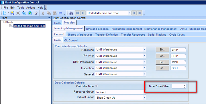

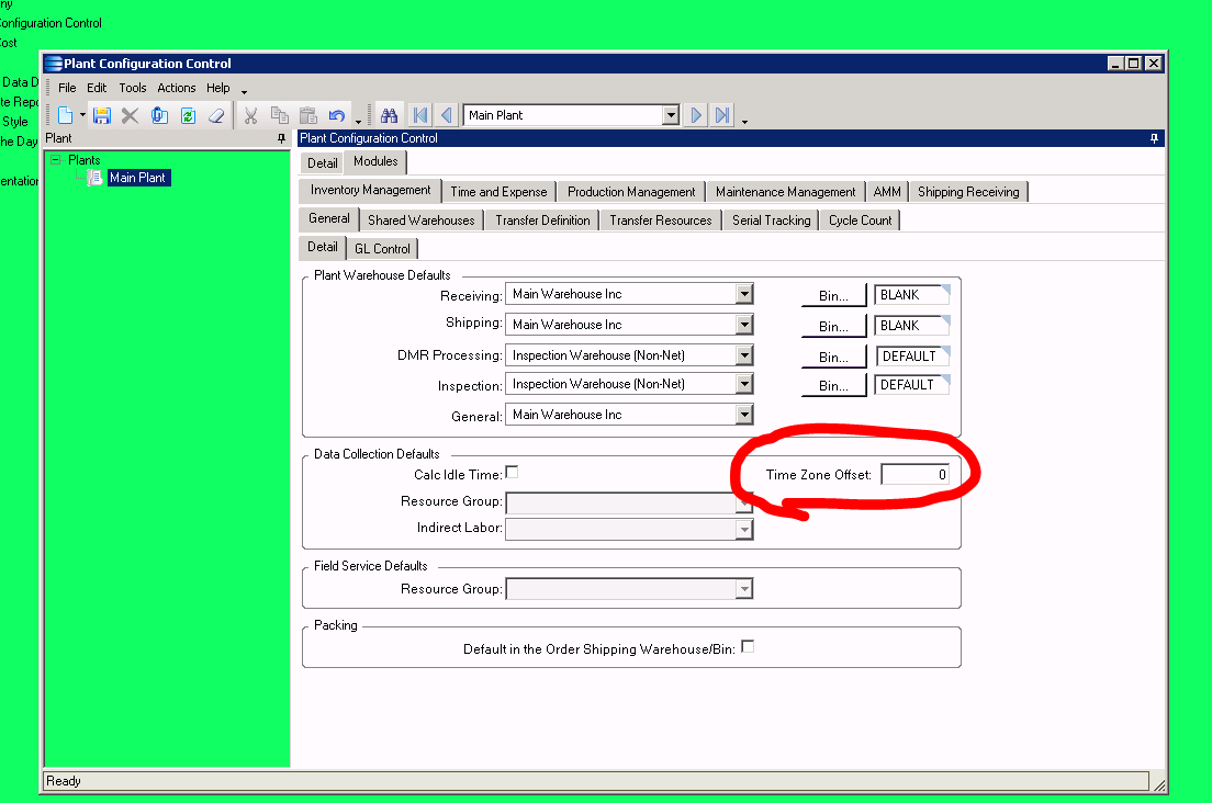

It’s been awhile since I’ve been in E9, but in Site Maintenance there is a field called Time Offset (or something similar). Do you have this set to something like -5 for the US company?
Do you mean here?
Correct, if the company is EST and the app server is UK time then put -5 in here for example. Of course, try this on a test server first to see if this produces expected results for your needs.
