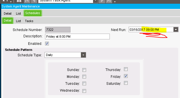

I have a schedule set for 8:00 PM on Fridays (created while on Standard Time), but the schedule now shows 9:00 PM (see Pict below)
Do most of you folks adjust the schedules’ next run time in the Sys Agent Maint?
Or leave it be and tell your users to deal with it?

What version of Epicor are you on?
For some context, when we create a system agent schedule in 10.x, the next run time set on the schedule
Is actually the UTC equivalent of the client time when it was submitted.
Whenever the timezone offset changes on the server(i.e. when daylight savings starts and ends), the execution time will be changed from the perspective of the client’s time but the process will execute at the time listed in the ice.sysagentsched table at that UTC time.
There is an enhancement request (186211) scheduled to be included in a future 10.x release that will allow a user to specify what the submitted/scheduled time on the schedule means; i.e. client time, server time or UTC time (how it behaves now).

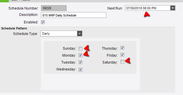

You ever saw the following behavior:
2018-07-30_1020
If you set it to 8PM EST which is 12:00AM UTC it does as it should behind the scenes it sets the Next Run to be 1 day later at 12:00AM UTC
However, it still runs on Sunday but it should not, despite Sunday being unchecked. Assumption is a bug in logic that probably checks Date and Time separately. So it assumes “Oh the date matches Monday”.
It could also be just 12:00AM exactly; I have yet to test 8:01PM, while 7:59pm works fine.
Haso, that’s interesting. We were told there’s a bug in 10.0 with daily schedules that have some days unchecked. Now I’m wondering if that’s related to EDT time adding 4 hours to convert to UTC time, which is then on the next day (that is unchecked!). We’ll have to see if that’s the trend.
