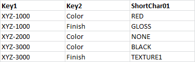

After 20 fields, I normally start offering a UD table where the fields are stored as separate records. This keeps speed and storage issues at a minimum.
So Key1 = Partnum, and Key2 = UDFieldname ??
Something like:
Since XYZ-2000 doesnt get painted, it doesn’t need a record for Finish
Exactly. This may be limiting if they need number, date or boolean, but one of the key values could be “type” and a BPM could check if the text matches that “type”.

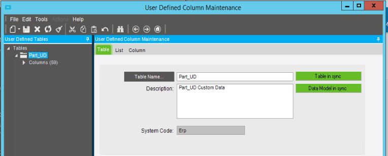

I’ve got 59 fields added to Part table - not noticeable slow down. :+1:
