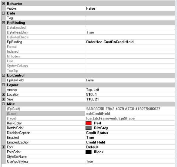

In Sales Order Entry, if the customer is on credit hold there is a red shape that appears:
so_CH
If there is no credit hold this shape is invisible (does not appear).

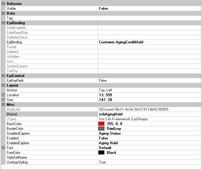

In the customization I see where this is defined:
So I tried to mimic this is Customer Maintenance. I couldn’t find a boolean field for credit holds, but I did find one for aging holds:
I also created a checkbox with the same EpiBinding (not shown).
Here are what the shape and checkbox look like for a customer with an Aging Hold:
cust_ah1
Ok, first of all, why is the shape green? This was the default but I changed it to red! (I tried closing and reopening the screen, to no effect.) The checkbox is checked as expected.

From looking at the fields on the Billing > Credit tab I can see that I appear to be using the correct EpiBinding. It’s not clear to me why it works with a checkbox but not the shape - we are looking for this to show up in bold red when on credit or aging hold but not display when the applicable hold is not active.
I’m not following what you mean about the color. I’ve set the background color to Red, but it seems to ignore that and always display visible+green, hold or not.

If I look in Sales Order Entry in the Summary tab, there are several shapes which seem to be linked directly (via an EpiBinding) to a database field. For instance, eshClosed is bound to OrderHed.OpenOrder. I don’t see any script code, so I guess there is something built in to do this.

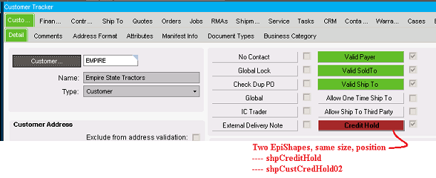

Here is a VERY quick example for the Customer Tracker.
Note that I used two shapes to account for loading multiple customers, where some are on credit hold and others are not. I know it is ugly but… I was just playing around with this. I would definitely do something “cleaner”, only one shape in a production version.
