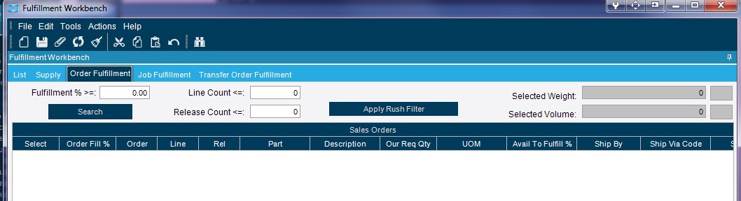

Is there a way to add columns to fulfillment workbench for orders? My users want to see OrderHed.EntryPerson on the grid.
The OrderHed.EntryPerson does not appear in the personalization collection on this screen.
The reason for the OrderHed.EntryPerson is not in the list is because the grid is displaying OrderRelease.
I think you can try to create a UD field in the OrderRel Table. But it needs to keep up to date on Entry person changes.
