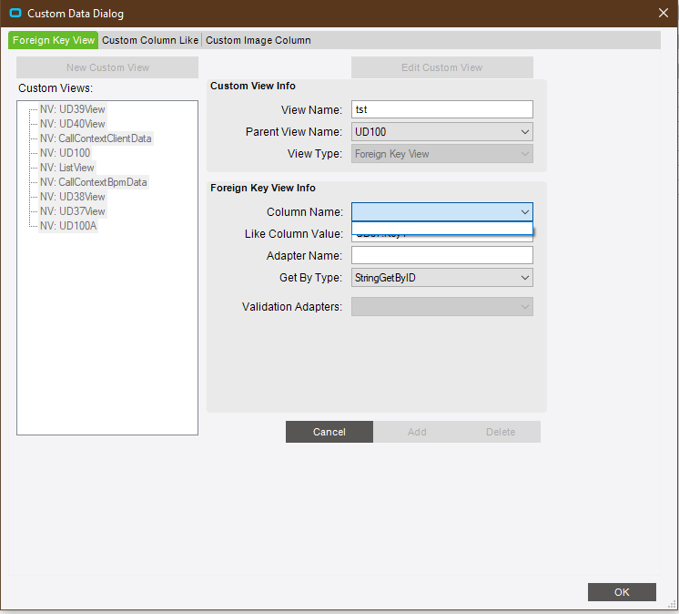

I was trying to create and FKV for a UD table. The Column Name drop down has no options:
Am I missing a step?

Ah, we don’t have access to the extended properties window (Still on MT, should be moving soon).
I can set some extended properties through code, but that wouldn’t help the designer know what to do… Maybe I should backup and state what I want to do…

You actually can set extended Properties right on the Customization.
Then it should show up in the FKV dropdown.
I tried that, the Column Name drop down still has no choices.
You might need to add it save and re-open Customization (close form completely, reopen)
I completely closed and reopened Epicor… still no luck.
Anyone have a few seconds to help me via the Windows 10 Quick Assist? Its probably something super simple…
Wait looking at your screenshot you have like set to UD37.Key1?
So you are trying to bring in another UDTable as a child ot a current UD table?
That’s not going to work because the primary key of UDTables is 5 keys in total. Not just one key like CustNum or OrderNum…
Your best bet here is to use a BAQDataView, which can subscribe to the published Character01 values.
I misunderstood I thought you wanted to bring UDXX table into a regular table via a 1 to 1 link like OrderNum or CustID etc…
One Option (and I haven’t tested this) is to Store the SysRowID of the UD37 Row in your UD100 table, then set the Like value to UD37.SysRowID that “MAY” work assuming that UD37 has a GetBySysRowID method.
I checked, that won’t work, so BAQDataView is your best bet.

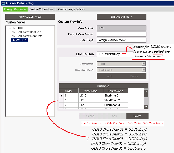

Yeah, that was the way I read Evans origianl post - why I was thinking ContextMenu.XML route.
Justfor fun I tested it in E10 - still seems to enable adding the FMKV for a UD - ref screen shot below
but… I don’t have any data in the tables & have no idea if it would work for Evan.
After his last post, I suspect there are better ways to get what he want anyway.
