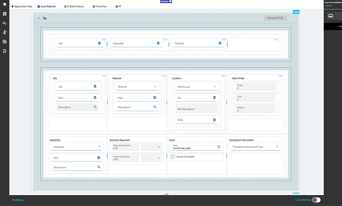

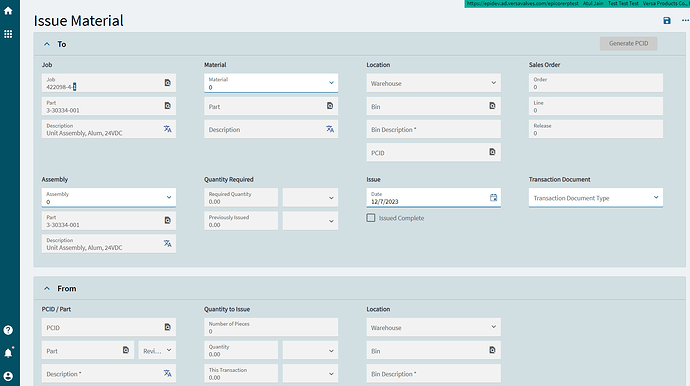

I am trying to use barcode scanner for Issue Material Screen,we are getting JOB,Assembly,Material from the barcode, only job is applied to the screen.
It works correctly for the this screen:
Hi,

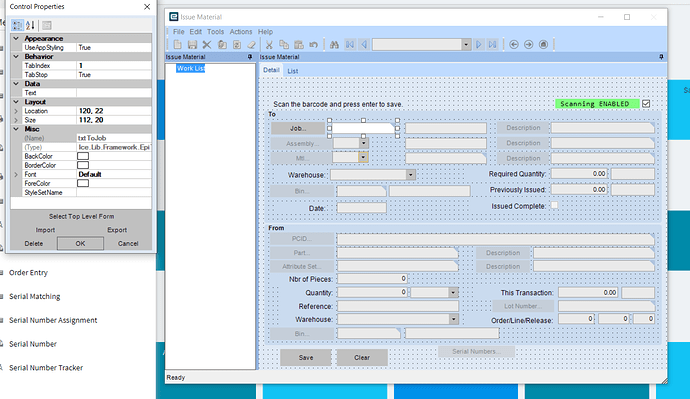

Have you checked the tab index n the UX screen and there may be an action that is refreshing the screen after job that you will have to work around.
