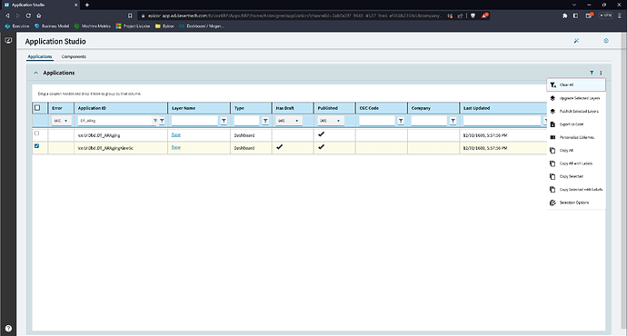

You may be stuck for now. In 2023.1 they allow you to delete apps and layers from that screen.
2023 uses ErpMetaFx.BulkDeleteLayers which works great.
No such method in versions < 2023.
Tried playing with ErpMetaFx.DeleteApp and it expects an app of type Configurator–lame.
