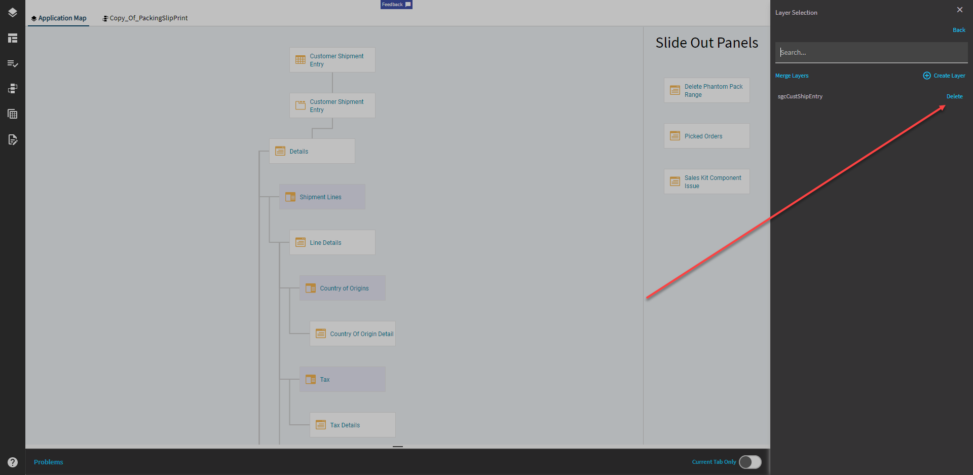

As far as I have seen, there is only an edit in application studio itself (although the edit button doesn’t work in 2021.2), but once you open the program you can click Change Layer which brings up the list of all the layers and delete them one by one there.
There is.
Yeah, what @aosemwengie1 said, lol.
No, I meant in the actual Application Studio landing page, not in an active customization.
Oh, no–you’re right. You cannot delete from there.
