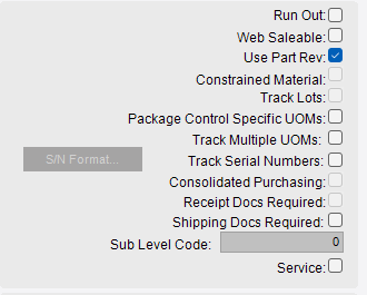

Hii, I would like to enable lot tracking for a part in the Part module (by checking the check box in the image below).
However, the box is not enable for certain users who are not security managers (?)
I was wondering which security/ menu maintenance settings would have to be turned on in order to allow users the ability to turn on lot tracking for a part?

What if you add new part is is read only?
If I create a new part, the check box is just grayed out (not able to be checked) unless I’m security manager…
Is there a bpm setting it to read only? or a customisation on the part entry screen?
Or check Field Security Maintenance. Did someone lock down that field based on security roles?
Hii, apparently it was a field based security issue, thank you for everyone’s help!
