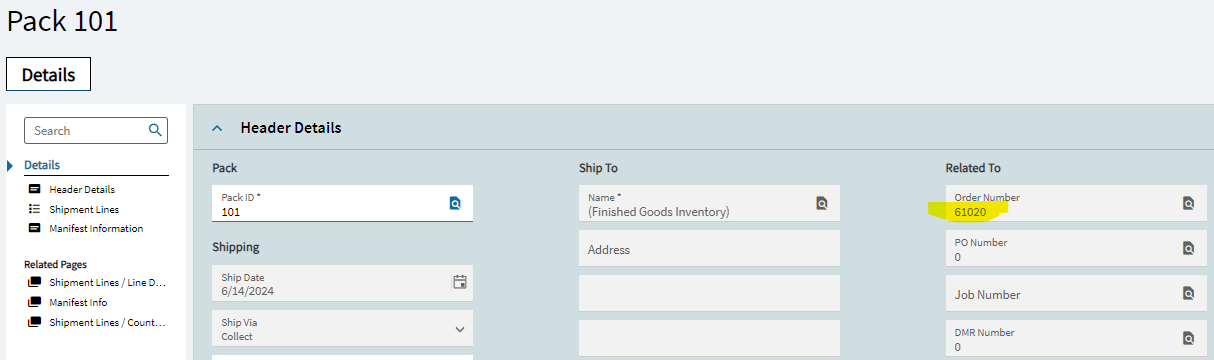

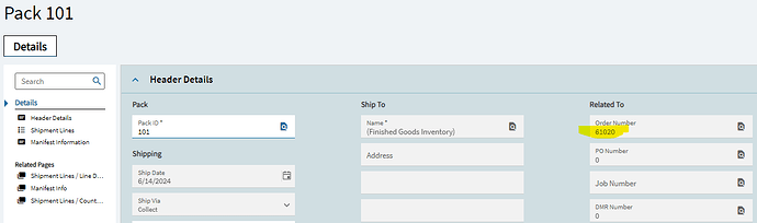

On the Misc. Shipment entry, you can even add the original SO number as a “Related To” link.

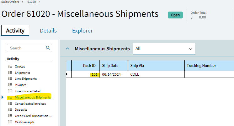

You will then see that Misc. Shipment in Order Entry if you look at the Activity tab
