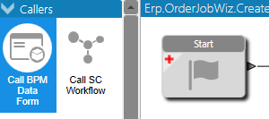

My assumption is that it is a BPM Form on a method. Have you checked the Method Directives or Data Directives to find it?
What do you mean by check the method directives or data directives to find “it?”
Is “it” the popup message?
All I know right now is that the question is stored in an out parameter on the UpdateMaster method called “qMessageStr.”
Yes, check the Method Directive Maintenance for UpdateMaster and see if there is a “Call BPM Data Form” in it.
