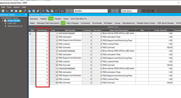

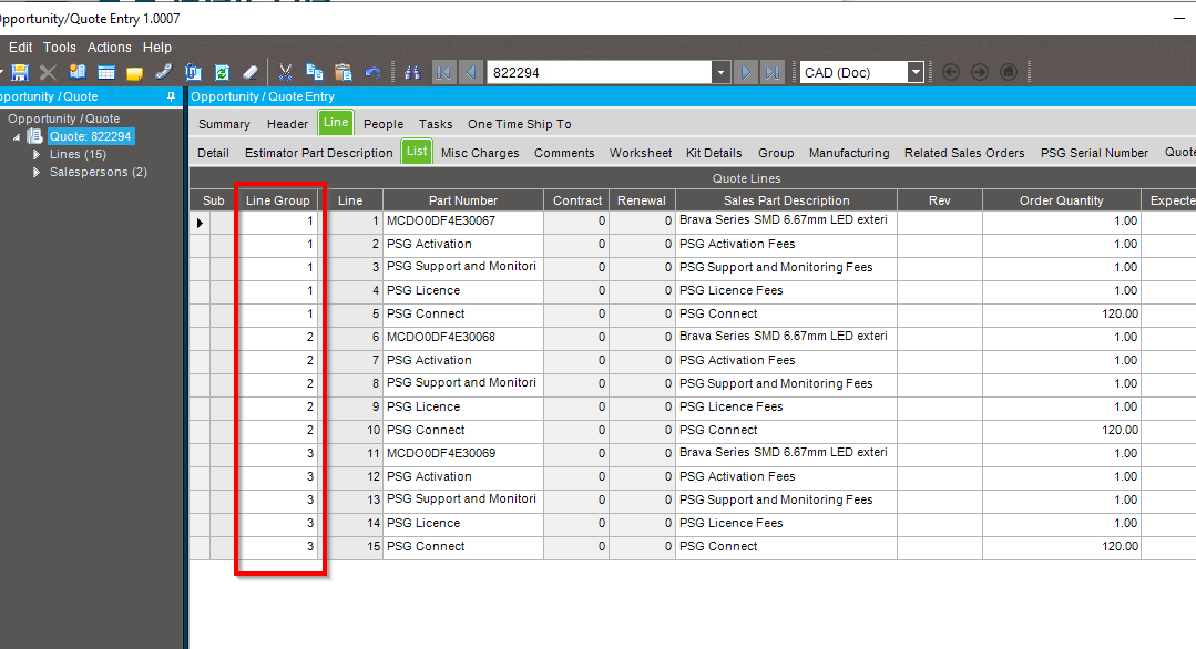

We created a customization in Opportunity Quote, Order Entry & AR Invoice entry. We linked a UD table to the form. This allows the user to create the lines that will print on the Quote Form, Sales Order Acknowledgement, or Invoice.
Then using a UD field at the line level, we enter the line group code. Finally, the modified form if it sees a ne line group will print this and not the documents line. Prices are total on the SSRS form.
That’s pretty slick! Seems really useful. Thank you for taking the time to type that out and show some examples of how it can work.

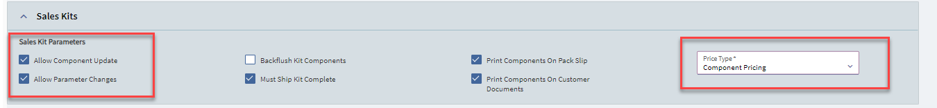

Sales Kits can be configured at the time of creating the order.
change your parameters to allow change materials and quantities.
No need for a job or customizations.

SalesKits are designed to be make to order, not make to stock.
To be clear, the part type is kit, it will have a revision which enables adding a bill of material.
There is no labor component, because the labor is minimal to the process.
A kit would be pull three orings and one oil filter and place in a box. Do that three times to ship out three oil filter kits.
The pricing of the kit can be driven by the selling price of the components.
