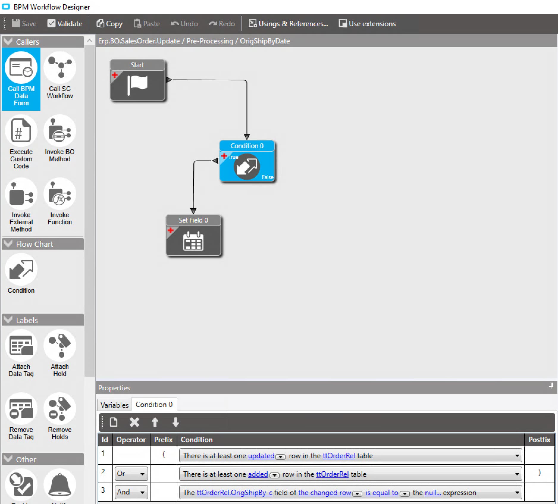

If anyone else out there is looking to do this, this is the BPM that I ended up using for this:
