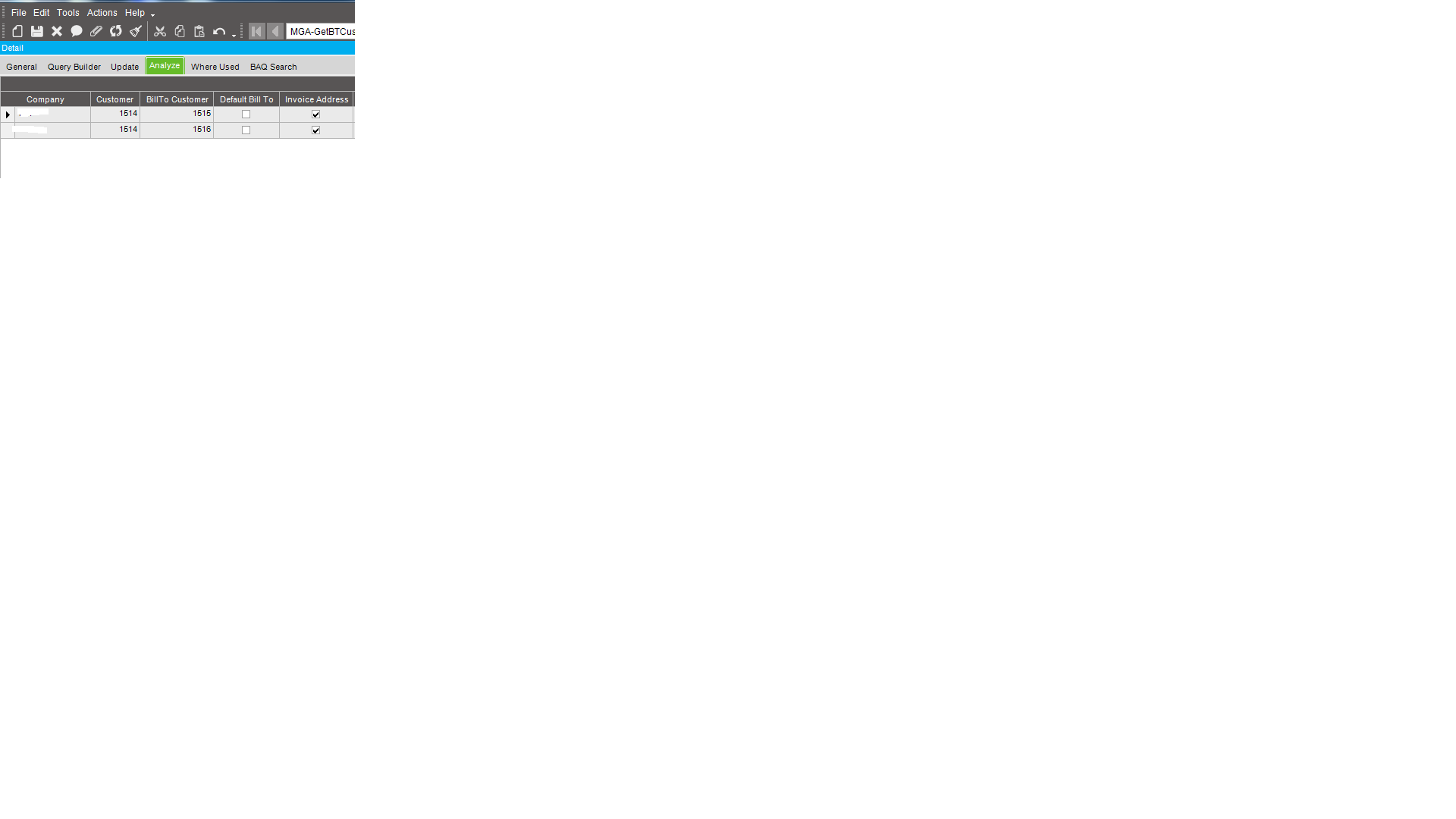

Table A is the CustBillTo where you would define alternate BillTo customers for the a customer, seen uploaded snapshot:
I have to lookup the customer name and use it for the description column in the drop-down list. As you can see from the snapshot, table A only has the Customer ID and BillTo ID.
