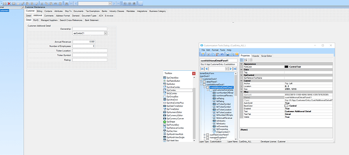

*In a simpler case, you can create a EpiCombo box, then populate the EpiStaticDataList. Note the Description indicating that the first line needs to define the columns. This is how you setup a static combo box that has a static list of values. However this can’t be linked to another combo box (to my knowledge).
Phew! Thats a lot. Catch up and let us know how it goes. Happy to hear an easier approach if there is one! Good luck!
This is the method that I was trying to do. What does this part mean though?
Look at the property description. I can see it on the bottom of your screenshot “Key~Description”. In your case, you may not need more than one column in your combo box, so you can probably skip it. Try it out, and let us know!
I am not sure what this means. When I tie that combo box to Customer.Industry, it still doesn’t have the data in dropdown. It wont even open. Back to youtube for more instructions!

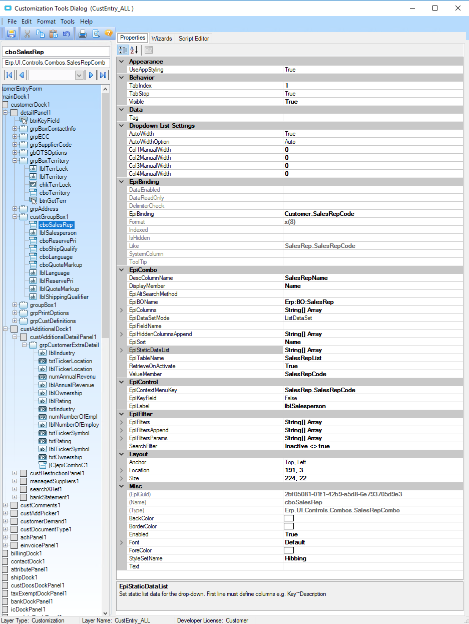

Here is a screenshot of my Sales Person Combo Box. Is this what you wanted to see?
Then here is the code behind that box in the script editor tab.

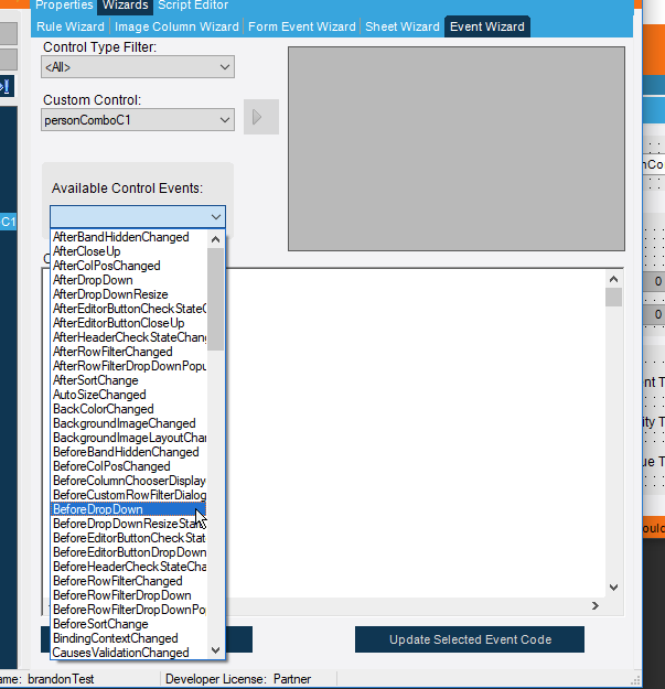

For this to work, you’re going to have to use an event on the control, before drop down, so that before the dropdown does a lookup, you’ll need to change the filter on the drop down (with code).
use the wizard to add the event.
Then if you look at the object explorer you can see the search filter property.
To start with, I would either run debug mode in Visual studio if you know how, or else just pop message boxes to see what the property looks like with hard coded values. Then you should be able to replace that with the value from the parent control.
This will allow you to dynamically change this value.

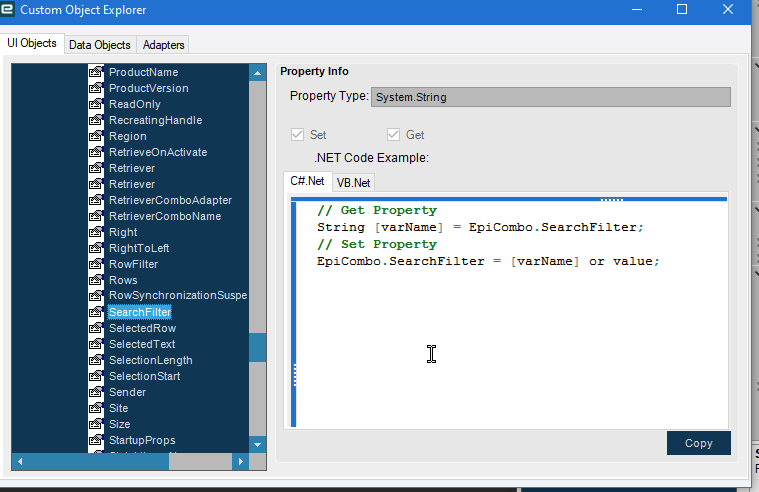

I was finally able to get the Object Explorer, but not sure what you mean message boxes to see what the property looks like. Would a screen shot help you from my end?
This is how you can pop a message box. Put that in your event, then you can put the current filter value in there.
MessageBox.Show(yourControlName.SearchFilter.ToString());
Or something like that. So manually set the filter to work with one of the parents, then do this to see what the property looks like, then match the format to change it.
