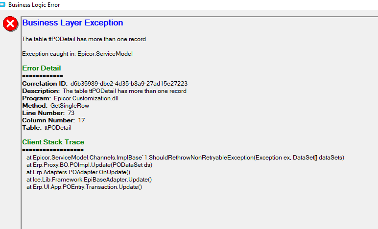

I’m trying to build a bpm that throws an error if a PO line does not have a reference in its GL Account link when the line is updated. I can get it to work if there is only one line. But, if there are multiple lines I am greeted with the following error.
How do I handle more than one record with a bpm?

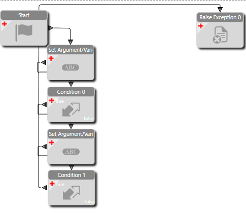

What does the BPM look like?
@knash,
Now what do the Widgets’ contents look like?
@ckrusen,
SetArgument 1 = key 1
Db.TranGLC.Where( r =>r.Company == callContextClient.CurrentCompany && r.Key1 == ttPODetailRow.PONUM.ToString() && r.Key2 == ttPODetailRow.POLine.ToString()).Select( r =>r.SegValue1).DefaultIfEmpty("").FirstOrDefault()
Condition 0 what does key 1 =?
if key1 = “1590” then true else false
set argument2 = key 2
Db.TranGLC.Where( r =>r.Company == callContextClient.CurrentCompany && r.Key1 == ttPODetailRow.PONUM.ToString() && r.Key2 == ttPODetailRow.POLine.ToString()).Select( r =>r.SegValue4).DefaultIfEmpty("").FirstOrDefault()
condition 1 what does key 2 =?
if key2 = “” true else false
raise exception text
WRONG!
Scalar Value 1 = key1
Scalar Value 2 = key2
I would put a condition at the start that the ttPODetailRow.RowMod = “A” or ttPODetailRow.RowMod=“U”. It should only fire then on the update or addition of a record.
@Doug,
Just gave that a try and noticed that that the ttPODetailRow.RowMod is coming in blank. Is this because I am in on a post-process? I have noticed that the error I put at the end of this is not stopping the update process at all. Also, running as a base process gives an error saying there are no entries in the temp table. Thoughts?
Oh, yeah. If you’re wanting to block the save, you want this as a pre-processing BPM. RowMod being blank means that there are no changes which would be the case in the post-processing method.
Tangentially related, you’ll also see blank RowMods in pre. When you update a row, the temp table will contain two rows: the old data with a blank RowMod and the new data with RowMod “U”. The order that the rows appear in is undefined. Don’t make the mistake of taking First, Single, or FirstOrDefault without a condition. Always use constructs like FirstOrDefault(o => o.RowMod == "U").

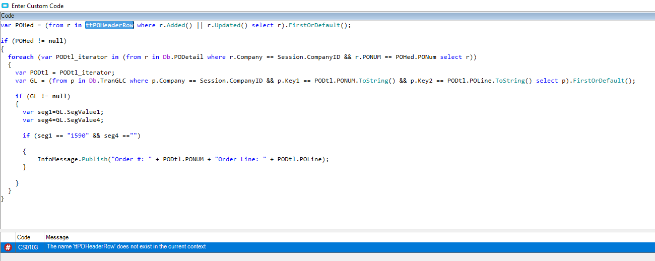

Gentlemen, I’m taking this in a different direction as the BPM isn’t reacting the way I was hoping it would. I’ve been following these posts and trying to recreate the custom code section:
My aim now is to pull all PO lines associated with the PO Number whose GL Segments 1 and 4 do not match my criteria. I have borrowed code snippets from the before mentioned discussions and have one error remaining before I can test it:
Once this code runs I want to hard stop / error out the update process until the user goes in and adds the necessary changes to the PO Line.
Does this seem viable?

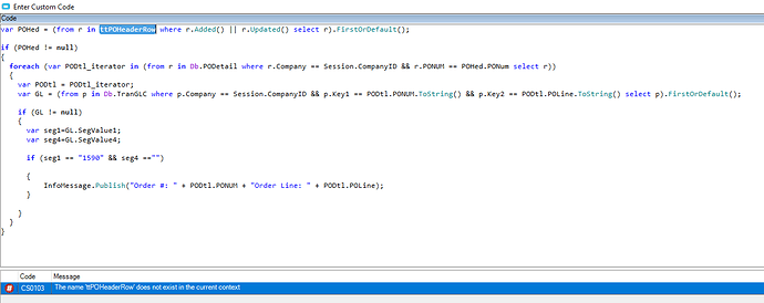

What am I missing with the TTPOHeaderRow table? It clearly exists but the code does not recognize it does.
Thanks for the assistance one and all.
I found my issue being that it needed to be TTPOHead instead.
