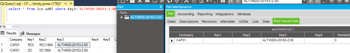

I have added a UD Child Table via Wizards on the Part Table.
I have linked by Part.PartNum=UD07.Key3.
I have added a new sheet and added an ultragrid and binded by UD07.
When uploading a part that does exist in UD07 nothing displays. I have a feeling from other posts that something is wrong in the coding but i am quite new to this and not sure what i am doing.
I am able to add a new record to the UD table, but am not able to delete.
In the code set initial UD Key Values it does not appear to be right as shows partnum against Key 2 not Key 3. I have amended this but still does not display.
Any help would be much appreciated.

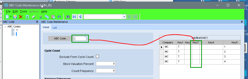

Because when you use the wizard, and even selecting Key3 as the filed to relate to the parent table, the code generated looks like:
	// Set initial UD Key values
	DataRow editRow = this._ud08Adapter.UD08Data.UD08.Rows[(rowCount - 1)];
	editRow.BeginEdit();
	editRow["Key1"] = abccode;
	editRow["Key2"] = string.Empty;
	editRow["Key3"] = string.Empty;
	editRow["Key4"] = string.Empty;
	editRow["Key5"] = lineNum.ToString();
	editRow.EndEdit();
Granted mine is C# and yours is VB, but the fact that the code always sets Key1 to the primary firled of the parent, remains the same.

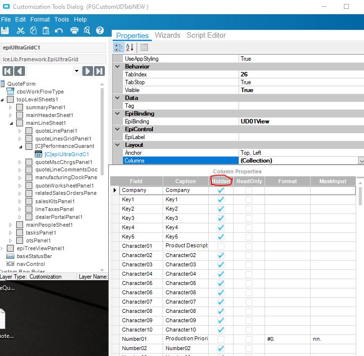

For any UD child table, you can hide any column. In many cases I hide all the key fields (because users populate the fields from the form).

Can you provide a snip of what some of the data lines look like in your UD07 table? Please show Keys 1-5 (at a minimum). This may help us diagnose the issue.
We populate UD07.key1 and UD07.key2 with either of the following entries from ud06 (This is not hard coded or anything just uploaded via DMT). UD07.Key3 we enter the partnumber, then put information into the number fields.
Below is the new one I have added when using key1 as suggested.
Hope all this makes sense
The UD07 record with the PN in Key1 and Keys3 won’t show, because your new customization is expecting Key3 to be blank. is only going to show UD07 records that match the settings in the wizard.
Or did you relate Part.PartNum-> Key1 and Part.PartNum->Key3 in the wizard?
