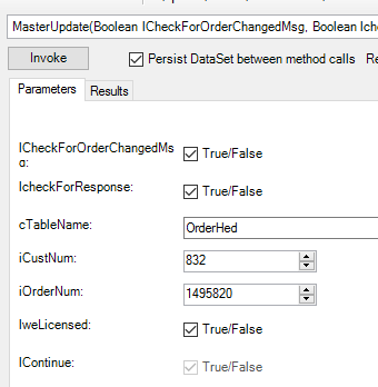

I’m testing some code in a ubaq that updates one custom field on the orderhed. I’ve followed the trace, and this also works in BL tester. When the same steps are ran in the UBAQ I get an error that no changes can be made because a release has been allocated. The thing is, I’m not touching the orderrel data. And in master update I specify that OrderHed is the changed table. What am I missing here?

BL Tester Params that work even when a release is allocated:
