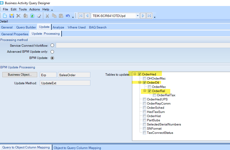

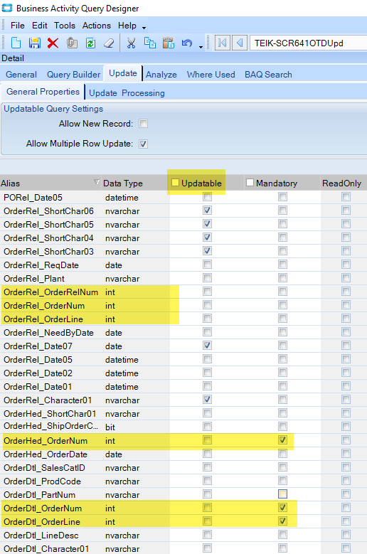

Hi Doug,
I have created an updatable dashboard on order release data and it works. I used the UD fields however. Here’s my setup, I’d think yours should be very similar except you provide firmrelease instead of my ud fields for update. You do need to have the orderhed, orderdtl and orderrel indexes in there for it to work, per use of UpdateExt on Sales Order. Perhaps these graphics will help you out, if it is feasible.
Nancy
Thanks when I indexed the 3 tables it worked.
