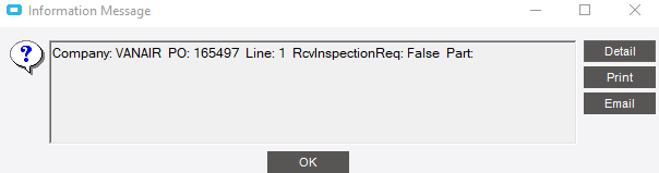

So I’m currently using a Data Directive and don’t get the Fill Table by Query. However, I am able to seemingly fill the table using code. I did confirm that using the DMT, it does update the record - and I thought the DMT used UpdateExt. The BPM does not uncheck the RcvInspectionReq flag, though. :frowning:
Here’s my code:
        IceRow newRow = dsPOUpdExt.PODetail.NewRow();
        if (newRow != null)
          newRow["Company"] = "VANAIR";
          newRow["PONUM"] = eachPO.PONUM;
          newRow["POLine"] = eachPO.POLine;
          newRow["RcvInspectionReq"] = false;
          dsPOUpdExt.PODetail.Add(newRow);
          var allRows = (from h in dsPOUpdExt.PODetail
                 select h);
          foreach (var eachRow in allRows)
            msg += "Company: " + eachRow.Company + "  PO: " + eachRow.PONUM.ToString() + "  Line: " + eachRow.POLine.ToString() + "  RcvInspectionReq: " + eachRow.RcvInspectionReq.ToString() + "  Part: " + eachRow.PartNum + "\n";
          bool errorsOccurred = false;
          boPO.UpdateExt(ref dsPOUpdExt, true, false, out errorsOccurred);
The bit in the middle is constructing a message to show me what the table has in it. It produces this message seemingly indicating that the table is getting populated like I’m expecting.
Why won’t the update happen? I bet I’m missing something simple…
