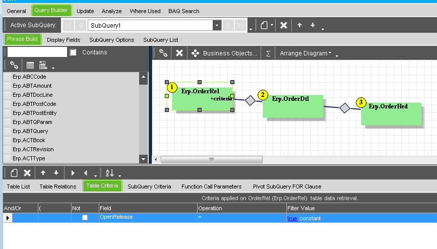

I create a simple updatable BAQ that allows updates to the ReqDate on the Sales Order Release. To get the update to work correctly, we have to include the OrderHed, OrderDtl, and OrderRel tables.
(We add a criteria on the OrderRel to limit our selection to open releases.)
We also have to include certain columns from each of these tables:

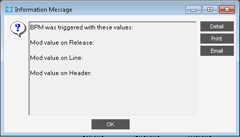

We press the Update button and get our first Message from the BPM indicating that it triggered successfully…
Note, however, that the Updated row value for our ReqDate is blank, while the Unchanged row is reporting the 12/31/18 date. Pressing OK to dismiss the first message, we see the Message after the conditional indicating that the False branch was taken…
The BMP is not recognizing that the data on that row was changed. Nonetheless, the update completes and when the BAQ is refreshed, the 12/31/18 date persists.
So what am I missing here? Shouldn’t the BPM recognize this row as being updated and changed?

To be clear, even the header does not appear to show as modified. The following mod values show up after changing the date field on added, modified or unchanged rows:

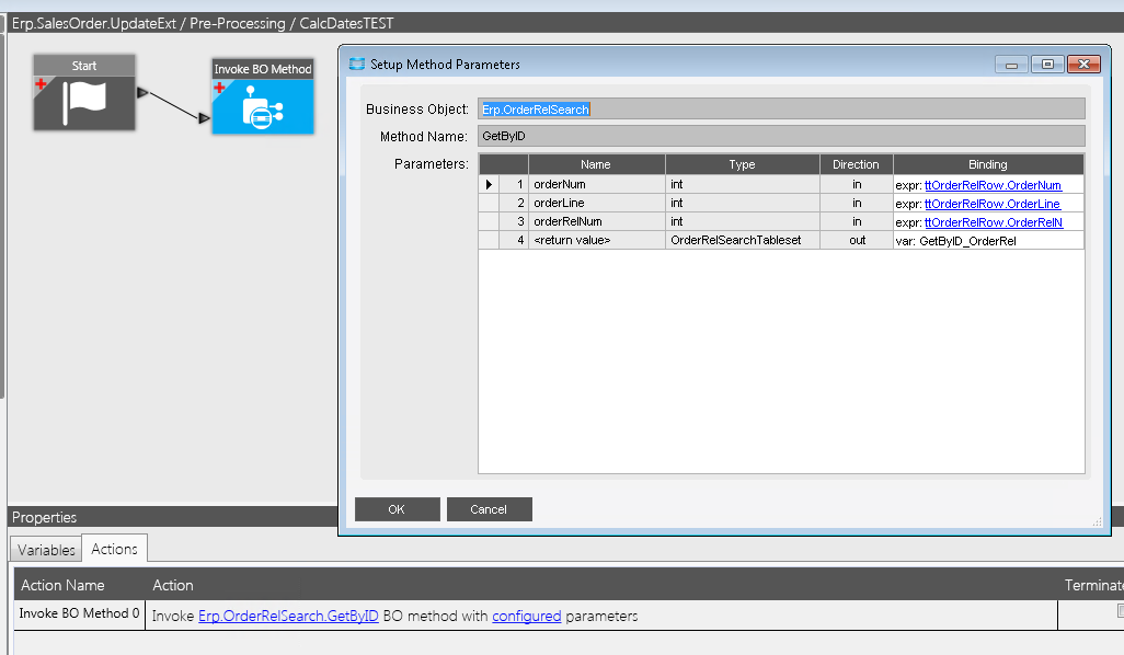

Alright, I am back on this issue. I am exploring Chris’ recommendation to retrieve the row data using an Invoke BO Method widget to call a GetByID method. In this case, I try the OrderRelSearch.GetByID method from within the SalesOrder.UpdateExt method. When I configure the method, I use values from the OrderRelRow temporary table and add a variable to store the data set.
It all appears OK, until I attempt to validate the workflow design at which point I get a series of data type errors that need to be addressed.
I use the Convert.ToInt32() function, which appears to solve the problem and the BMP validates. When I attempt to enable the BPM, however, I get this server side error:
There is at least one compilation error.
UpdateExt.CommonTypes.cs(254,33): error CS0433: The type ‘OrderRelTable’ exists in both ‘Erp.Contracts.BO.OrderRelSearch, Version=10.1.600.0, Culture=neutral, PublicKeyToken=5d3fa3c7105d7992’ and ‘Erp.Contracts.BO.SalesOrder, Version=10.1.600.0, Culture=neutral, PublicKeyToken=5d3fa3c7105d7992’
UpdateExt.CommonTypes.cs(100,55): error CS0433: The type ‘OrderRelRow’ exists in both ‘Erp.Contracts.BO.OrderRelSearch, Version=10.1.600.0, Culture=neutral, PublicKeyToken=5d3fa3c7105d7992’ and ‘Erp.Contracts.BO.SalesOrder, Version=10.1.600.0, Culture=neutral, PublicKeyToken=5d3fa3c7105d7992’
This makes me think that I cannot use the OrderRelSearch.GetByID method within the SalesOrder.UpdateExt method. In this case, there does not appear to be another BO Method that will do the trick.
What am I missing?

Looks like an ambiguity issue - they have since solved this 10.2 using externs.

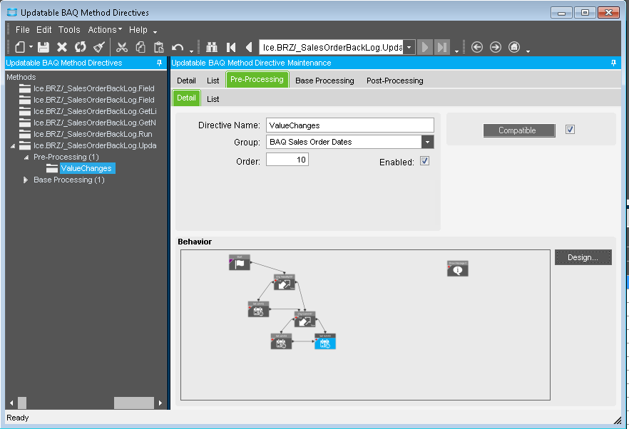

Thank to Rich’s input, I was able to use the BPM Directive Configuration to help accomplish my objective. I added a preprocessing BPM on the Update method.
Within the context of this method, the field changes were detectable and I was able to use conditional widgets to set BAQ Data fields to pass to the subsequent methods–specifically the SalesOrder.UpdateExt method.
There is quite a bit going on in this BPM…
