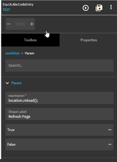

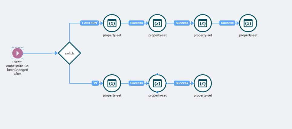

I have a page with several panel cards, with various controls in each one, hidden by default. There is a combo box at the top of the page and based upon what is selected certain cards are shown. I have one of the options in the combo box to be reset. In the change event I have a switch statement to show what cards need to be displayed. I can add an option for when “RESET” is selected but can’t find something in the toolbox to refresh the page. I am wanting to to this instead of having functionality to re-hide the panel cards not to mention retuning the controls inside the cards to a good state. Does this sound reasonable or is there a better way of doing this?

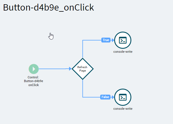

Thanks!! That worked. I may have to figure something else out later. The more stuff I add, I assume, the longer the reload will be? By the way where does the console-write write to? The browser console?
I only added the console part because it needs “something” otherwise it yells. And yes it writes to the browser console. I recommend putting in there something amusing and wait for someone to call you out on it!

Thanks. Yeah I tried without anything too and it gave me an “There should be only 1 or 2 connections from a condition action” error.
Jose, you saved my bacon on this one. We are using a selector column and for some reason, the refresh doesn’t work after selecting and updating rows. Forcing the page to reload per your example is the only thing that has worked.
