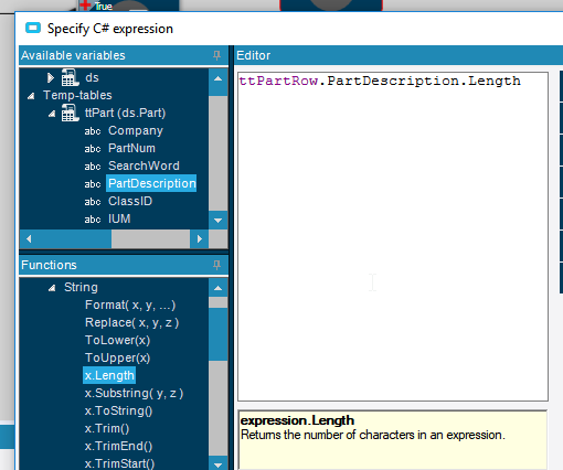

Just do a condition to check for the length of the field. And if less than 5, raise an exception. Probably put it on the update method.
You’ll need to do a C# expression to check the length of the field, but that’s a quick google search to figure that out.

That method is already in the menu as well. Create a variable, the set it using the set variable widget, then you can make the condition to check if the variable is a high enough number.
