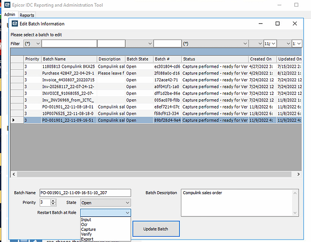

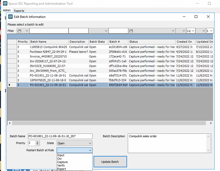

@utaylor You can restart the process in the web site in the Admin Panel pick batches then there is a restart all selected. I only do one document per batch so my document name matches the pdf name plus a date time stamp and they are dropped into a folder not processed by the email input so I would look in the processed subfolder for matching times.
You can also do the restart from the server admin tool.
