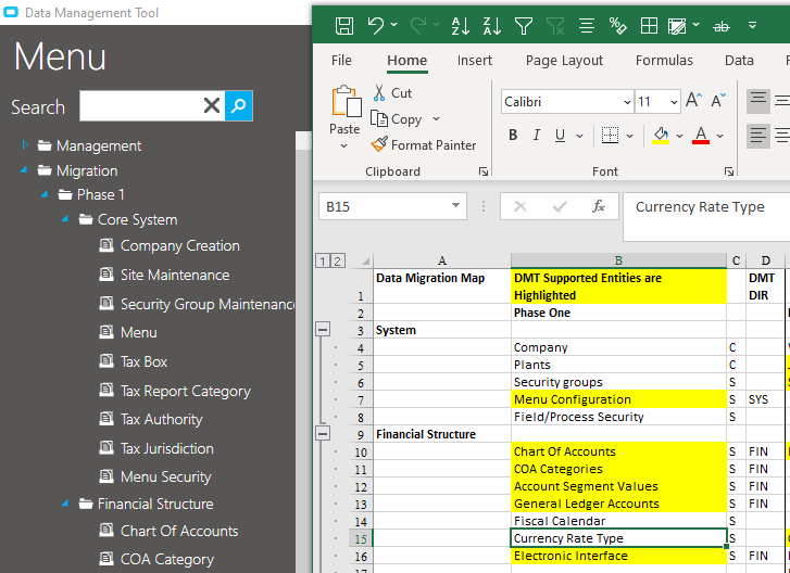

Our CAM gave us one that was really excellent. I’d share it, but it looks proprietary.
It is called:
  • Data Migration Map
  • Epicor 9.05 Data Map v1.8
  • Dot Net IT Limited © 2013
I know it says 9.05, but we used it for 10.2.500 and it was just fine. The concepts have not changed. So maybe your CAM can help.
Basically the DMT migration section is laid out identically, though, so you could use that. But the Excel file is easier to read and had a little more detail.
A sneak peek:
