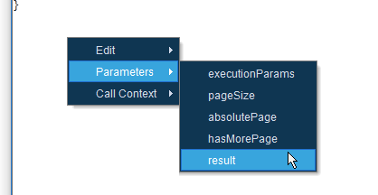

They changed is so it’s not TT tables anymore. It looks like in GetRows on the BAQ it’s a parameter “result”. Usually when I’m looking for the resident dataset, I just right click in the code window, and look at the parameters. Sometimes it’s result, sometimes it’s ds.results, so it depends on where you are.
That was it. Thank you so much.
