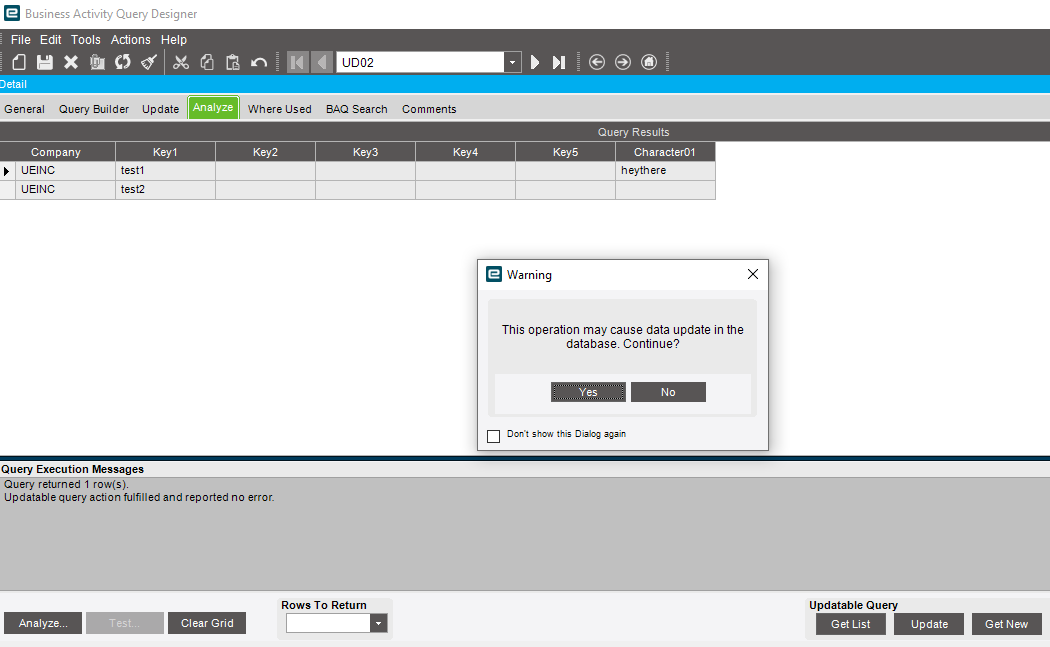

This operation may cause data update in the database
We get this when clicking Get List on a updatable BAQ. I remember in the past a consultant said we could write a baq report that could be put on a schedule to update data overnight. Never figured out how that was done.
Is it possible? When I try to Get List it only fires the BPM once, not once per line. How can an updatable baq just run and change data? I can set fields but when I hit update it reports that no rows were updated.

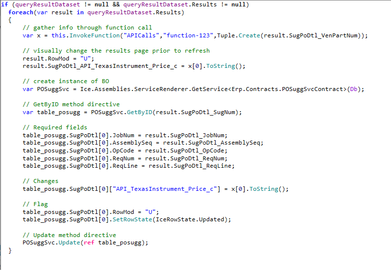

But I’m working on such a lovely c# script… probably missing something in there because it complains

You have to set the row mods if you are changing in a post processing get list, and allow multiple dirty rows on your UBAQ.
