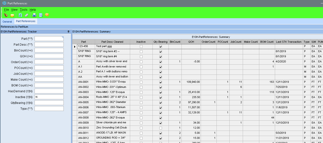

Here’s a BAQ and Dashboard that lists all the parts in the part table, and the count of “open references” for that part.
E10H_PartReferences.dbd (355.9 KB)
Most of the columns are self explanatory. Some that aren’t (or have conditions):
  • Order Count - Number of Orders were the part is on an open line
  • PO Count - Number of PO’s were the part is on an open line
  • Job Count - Number of Jobs where the part is a material and is not Issued Complete, and the Job is Open
  • Make Count - the number of open jobs where the part is what is being made
  • BOM Count - number of BOM’s where the part is a material, and the BOM Rev is Approved.
The BAQ might look complex but it’s really not. You might want to add a sub query to include the Parts references to Methods on Quotes. Limit it to ones that are marked Template.
All of this just gives you visibility to where a part is being referenced.
A more integrated solution to your problem would be a BPM fires when a Part is marked inactive, and checks for all these references. If any are found, show a message to the user and prevent the change to Inactive.
