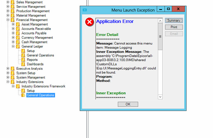

Industry Extensions Framework installation on 10.2 Errrors

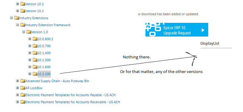

Anyone been able to successfully install IEX Framework on 10.2.100?
There is no installation guide.
The installation exe seems to only create the menu items, but does not copy the required DLLs to appropriate folders.
I had logged 2 support calls that have appeared to gone into File 13.

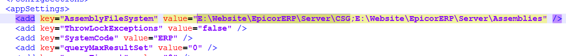

Probably reinstall IEx and ACH from EpicWeb, they do have it looks like a 10.2.x version, then add the CSG Folder to your web.config and restart IIS

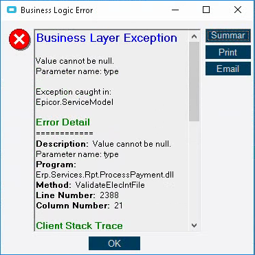

Made the change to reference _SVN in the Electronic Interface and tried running, but getting Value cannot be null. Parameter name: type
Back to the drawing board.
Thoughts are A) to plug in our BankCompID in the the company.FEIN field, but that should be our Federal Tax Id, B) modify Payment_US_ACH_Domestic.cs - extremely dangerous or C) post process the file and replace the three locations of FEIN with BankCompID…
@Humberto_Martinez Any ideas on the previous?
I don’t think that BankCompID is the one null, if you notice it is being validated at the beginning of the method buildInfo.
The only way to fund out what the issue is, is to debug, try to force the program to debug with this line of code: System.Diagnostics.Debugger.Launch(); and go thru the code until you find the null value.
