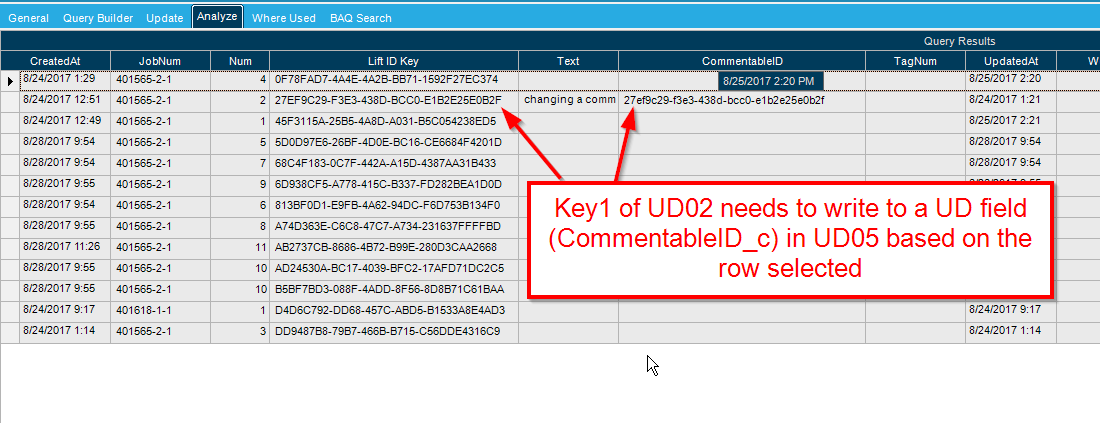

Here’s what I have going on. I have 2 UD tables that are tied together in a query. One is the list of containers, and the other table is a comments table that is tied to the first with a GUID in key1 to another field. I want to be able to make an updateable dashboard to allow the users to add comments from the dashboard because adding them by typing on the screen of an IPOD touch (the devices they are using on the shop floor) can be a pain.
Making the change part of it is not too hard and I have that working with the help of Jose Gomez. But it can only change a value, and if a comment has not been made yet, there isn’t a row to change in the comments table, and I have to add new.
That brings me to the world of the Column initial expression to create the first row to be able to update and I’m a bit stuck.
First, I need to create a GUID for key 1 on UD05. After some googling… it looks like System.Guid.NewGuid().ToString() comes back with no errors, we’ll see if that works.
Next is the date time. I’m going to try to constant it give me for today (Constants.Today) but I don’t think it’s going to give me the right format (MM/DD/YYY HH:MM AM/PM) but we’ll see what it gets me. I need an actual time in there, and I think it’s going to give me 12:00 am.
The last thing that I need and I don’t know how to get, is the Key 1 from the other table (UD02) that is on the row that I want to add the comment to. That’s how the system knows that this comment on UD05 goes with this container. I was expecting to have some fields to pick from in the Updateable Field Initial Expression, but It doesn’t
Do I have to do this with a customization? Below is a screen shot of the UBAQ. The comments fields are empty because it’s a left join of the UD02 to UD05 table and UD05 doesn’t have rows yet for the containers with no comments.

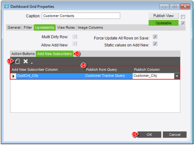

My preferred way of adding new records in an updatable BAQ is to use the publish>subscribe functionality with multiple grids. In a normal dashboard, you can publish a value from one BAQ/grid and then use that to filter the results in the next grid. For updatable dashboards, those published values can become field values for new rows. The updatable grid properties has a tab dedicated to these settings.
Thanks Craig,
I just looked up the EpicorICETools_UserGuide and found out you can do it via the Updatability tab on page 1103.
