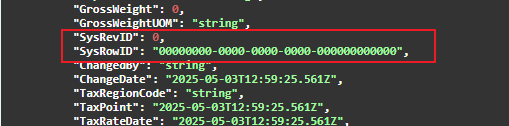

I found out the SysRevID and SysRowID from the returned ds object still showing invalid value, when it will change to valid value? because if i pass this ds to UpdateMaster it will pass this invalid SysRevID and SysRowID to it right?

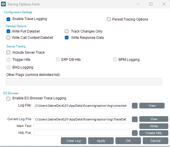

this is what i do, i open kinetic , open tracing option and using the setting as pic
then i open receipt entry and add new record and after done i off kinetic and load the file to Epicor trace Parser and i could not find receipt related BO from the list, which step i do it wrong?
i only see 4 BO which is
Ice.Proxy.BO.UserTracingImpl
Ice.Proxy.BO.SysMonitorImpl
Ice.Proxy.BO.UserFileImpl
Ice.Proxy.Lib.SessionModImpl
Are you using the Kinetic UX? That tracer you are showing is for Classic interface.
