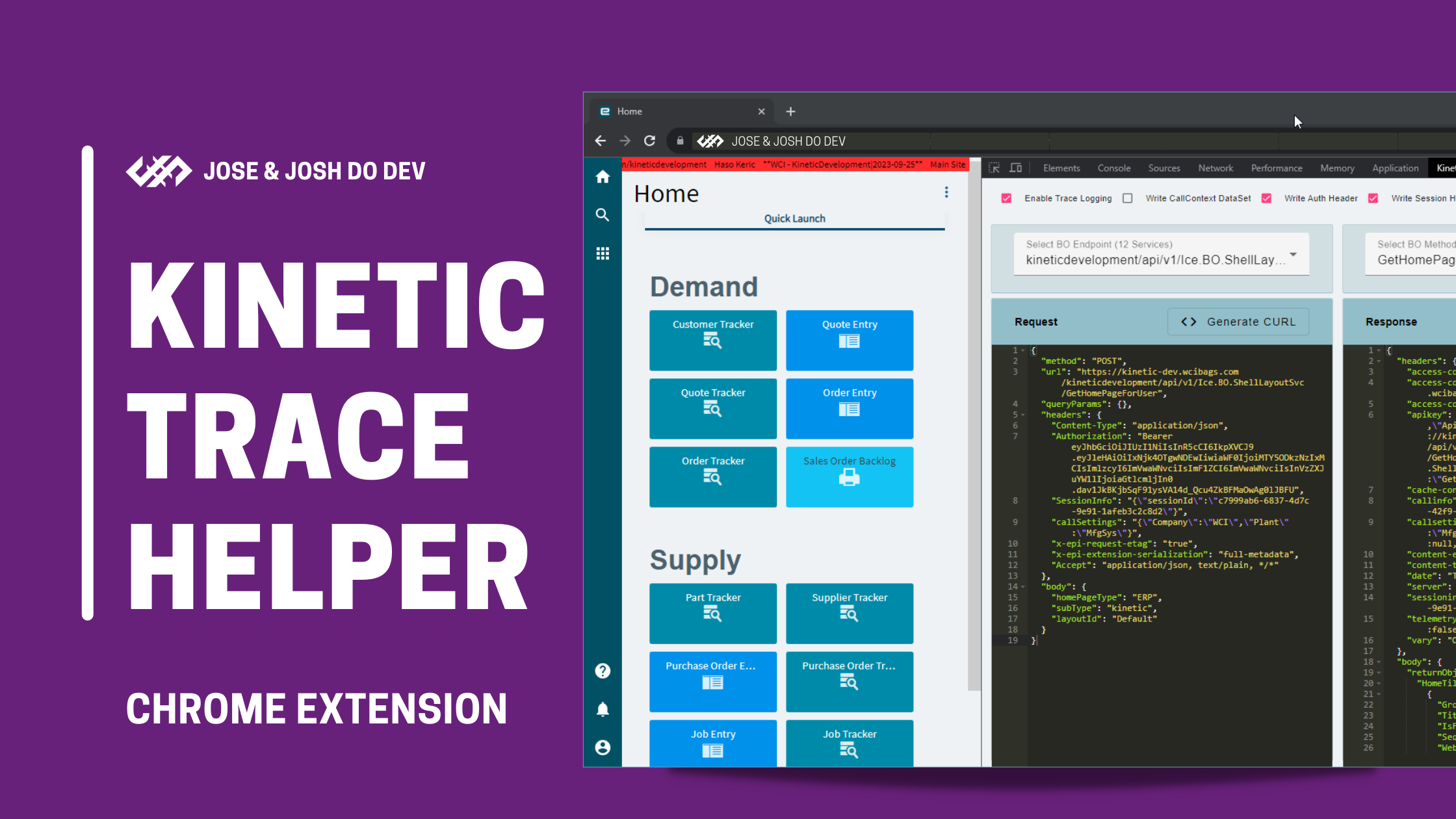

Honestly, the ONLY sure-fire to know this is through a trace. I’ve spent way too many hours trying to divine what Epicor was thinking and discovered the truth was always available - just in a form I was unwilling to look at.
F12 is your friend. There is also a Chrome extension that might help.

Nonetheless… I assume kinetic is actually a chrome instance that is packaged to run as a native app then? And from there… I debug and see all the actual HTTP API calls that are being made in order to duplicate?
Not dumb, I assumed you were at a newer version. For the classic client:
Kinetic is web based. In the Kinetic versions (K2021…), the client uses the embedded EO browser to display the pages, but those pages will also work in Chrome, Edge, etc.
Worth noting: the traces might change between the client and the browser, so you might have to tweak your program when you upgrade.
