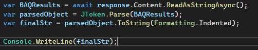

Might take me a second to parse what you are doing exactly, but if you want to “prettify” the json you are getting back you can just use Newtonsoft.Json, and do this:
//ref Newtonsoft.Json
using Newtonsoft.Json;
string pretty = JToken.Parse(BAQResults).ToString();
Thanks for your response!
I just attempted that and got it to prettify but it cuts out over half of my dataset for some reason. I’m pulling two companies worth of data. The results that I get when it IS formatted correctly cuts out all Vendors of one company and picks of in the letter ‘N’ in the second company. Its super weird because it’s not even the start of that Vendor, it’s half of the object too. It’s like a character is in the string that’s throwing it off somehow but there isn’t anything crazy in the raw data and Postman display the results with no problem.
Interesting. You can leave off the Formatting.Indented, JToken.Parse().ToString() default is indented.
