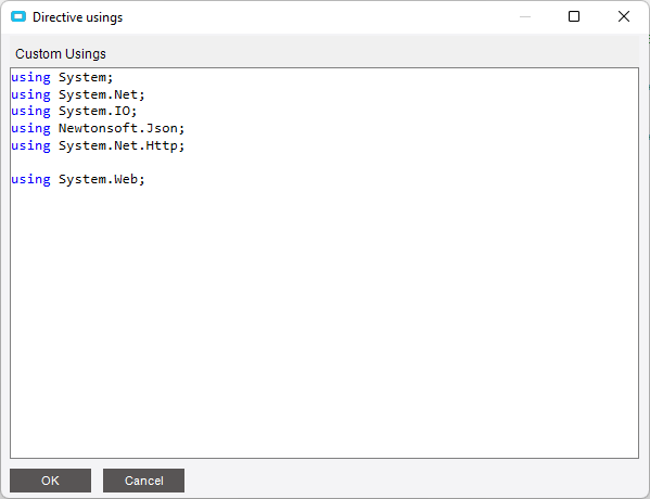

To add onto Kevin’s in-depth response, here’s an example of me calling an external web service via a BPM (well, inside an Epicor Function) by reading a row from a UD table. With the response from your web service, you’d then be able to further do something with the data i.e. write it to a record or whatever.

Obviously your external web service will dictate the response behavior but this is intended to give you an idea about the mechanisms needed to call a web service inside a BPM and work with a response.
