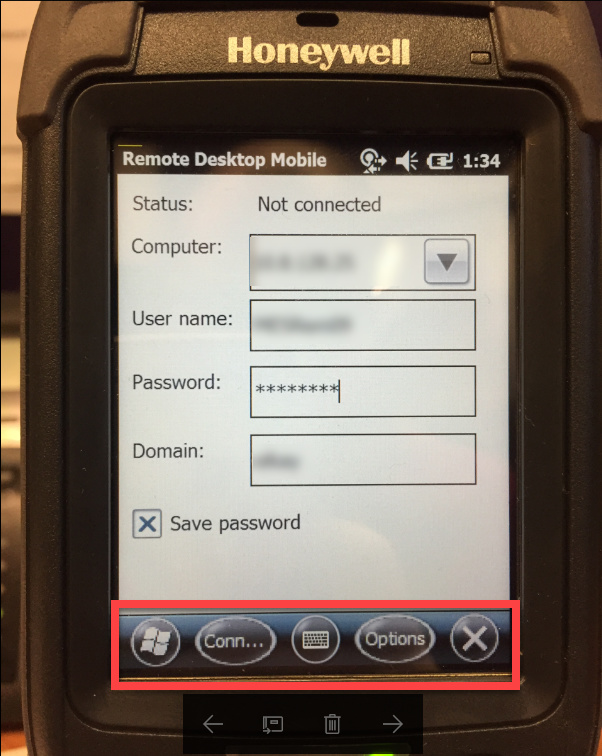

@Jim, that didn’t seem to work. It still brings up that RDP bar when it’s in full screen mode.
And to be clear, it’s the red box that pops up when I hit F1 or F2.
@hmwillett Looks like SR12051500 cab is not installed or working correctly for you. I disabled my F1 key remapping and was able to replicate your issue.

@Jim, I have it set so that F2 is the “=” key.
When I’m in Epicor in the RDP session and I hit F2, it brings up the RDP menu.
If I hit “=”, however, it functions like F2 in Epicor.
I was under the impression that I could still hit F2 and have it accept F2 in Epicor, not remap F2 to another key, hit the other key, and have that act as F2 in Epicor.
Your impression on how it should work is correct. Did you modify both the ConfigureRemapRDM.exe and the text file?
