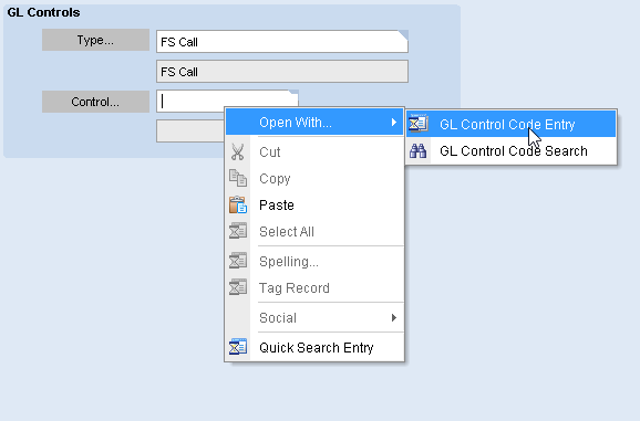

While the GLC’s elements need to be created in the order above, you can start at #3 and use the right click on the Control entry text box to launch the GL Control Code Entry
And that will automatically select the proper type for the GLC Code you’re about to create.
