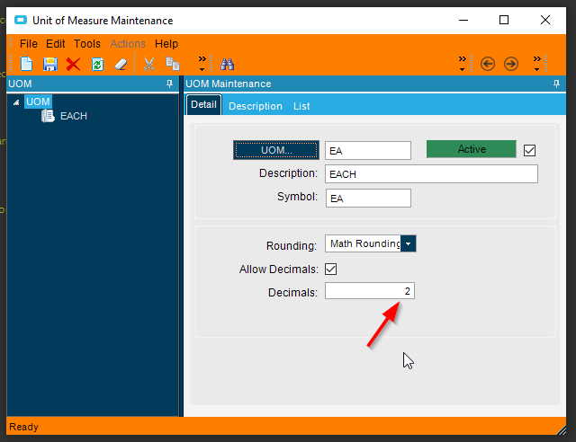

You have to go and adjust the allowable decimals to what you need, make the change, then put it back. It’s annoying.
First I thought that would be a scary choice since it affects all EA UOM… but apparently there is no other solution… it did the fix. Thank you!
