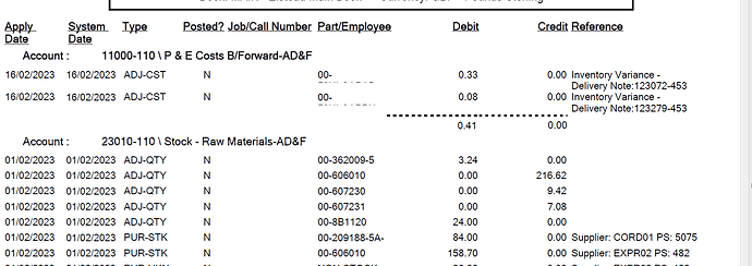

Hello, We have ran our capture cos wip and now run the inventory wip reconcilliation report and it shows and adjustment out for a product but it shows as credit and our WIP is out by £215
Try to find out the transaction in question, and, check the GL Control.
You have mentioned WIP is out, I assume for manufacturing related jobs - you might have defined GL Control at company level, check it. Or related part GL control may not defined.
