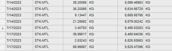

I am seeing a problem That I am having a hard time figuring out. Inventory seems to go backwards when back-flushing parts. Our running totals are slowly going up instead of down.
Check how you are ordering your grid. It looks like it’s going up until you jump days, then it goes down. Show your transaction ID number and sort by that, and I think you’ll see that your fine. The date field is only a date, not a date time, so it can’t sort with enough granularity.
Thanks, There were to many trees so I could not see the forest… :slight_smile:
