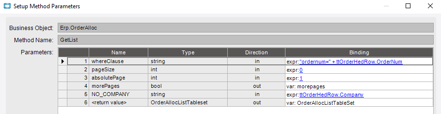

  1. Invoke BO Method: Invoke erp.OrderAlloc.getList - Parameters:
This then brings back the OrderAllocListTableSet

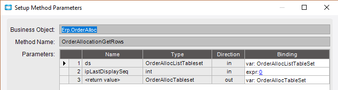

  1. Invoke BO Method: Invoke erp.OrderAlloc.OrderAllocationGetRows - Parameters: image
This uses the OrderAllocListTableSet to bring back the OrderAllocTableSet Information

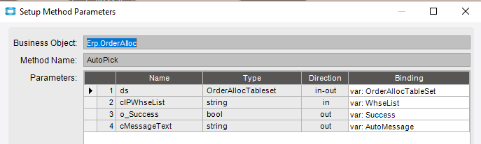

  1. Invoke BO Method: Invoke erp.OrderAlloc.AuoPick - Parameters: image

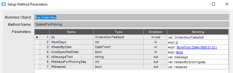

  2. Invoke BO Method: Invoke erp.OrderAlloc.SubmitForPicking - Parameters:
This should then move the allocated stock to picking, when using the logic tester tool, this has triggered and is correct, however from inside epicor i can not achieve this.
