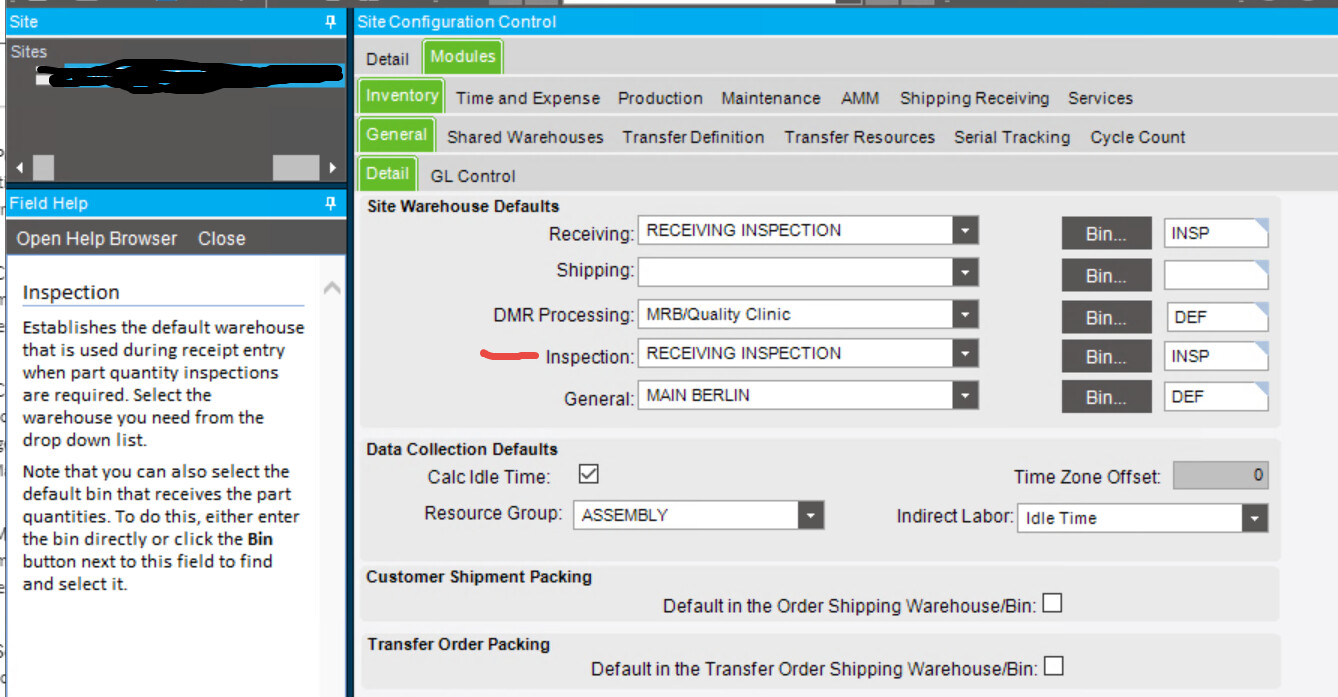

In E10 all our POs that had Inspection Required checked went to the default inspection location set up in site maintenance. Since we upgraded to Kinetic the subcontract POs are not going there upon receipt, they are going to the part default location. We opened a support ticket and Epicor is telling us we need Advanced Material Management to use the locations set up in Site Maintenance and it was a bug that the receipts were defaulting to the Inspection location. All our material to inventory POs still default to the inspection location and Epicor says this is also a bug, all POs should default to the bin in the part master even if it needs inspection.
Sadly I’ve never tried using Kinetic with no AMM licence, so I’m not much help.
But what I would expect if you weren’t licenced for a field then it would be either read only or would throw an exception when saving. (might want to try changing the warehouse and see…on test environment of course)
I would be inclined to check the site config screen in the kinetic UI to check the behaviour, as well as checking out Demo.
Update: We opened a new support ticket and now Epicor support is saying we are correct, it should be defaulting to the Site defaults even without AMM.
